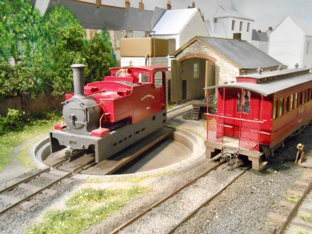

Le dépot.
Rouge ! Une livrée qui devrait attirer Gilles et Laisse-les-dire.
Enfin, une occasion de découvrir le cousin irlandais de PME.

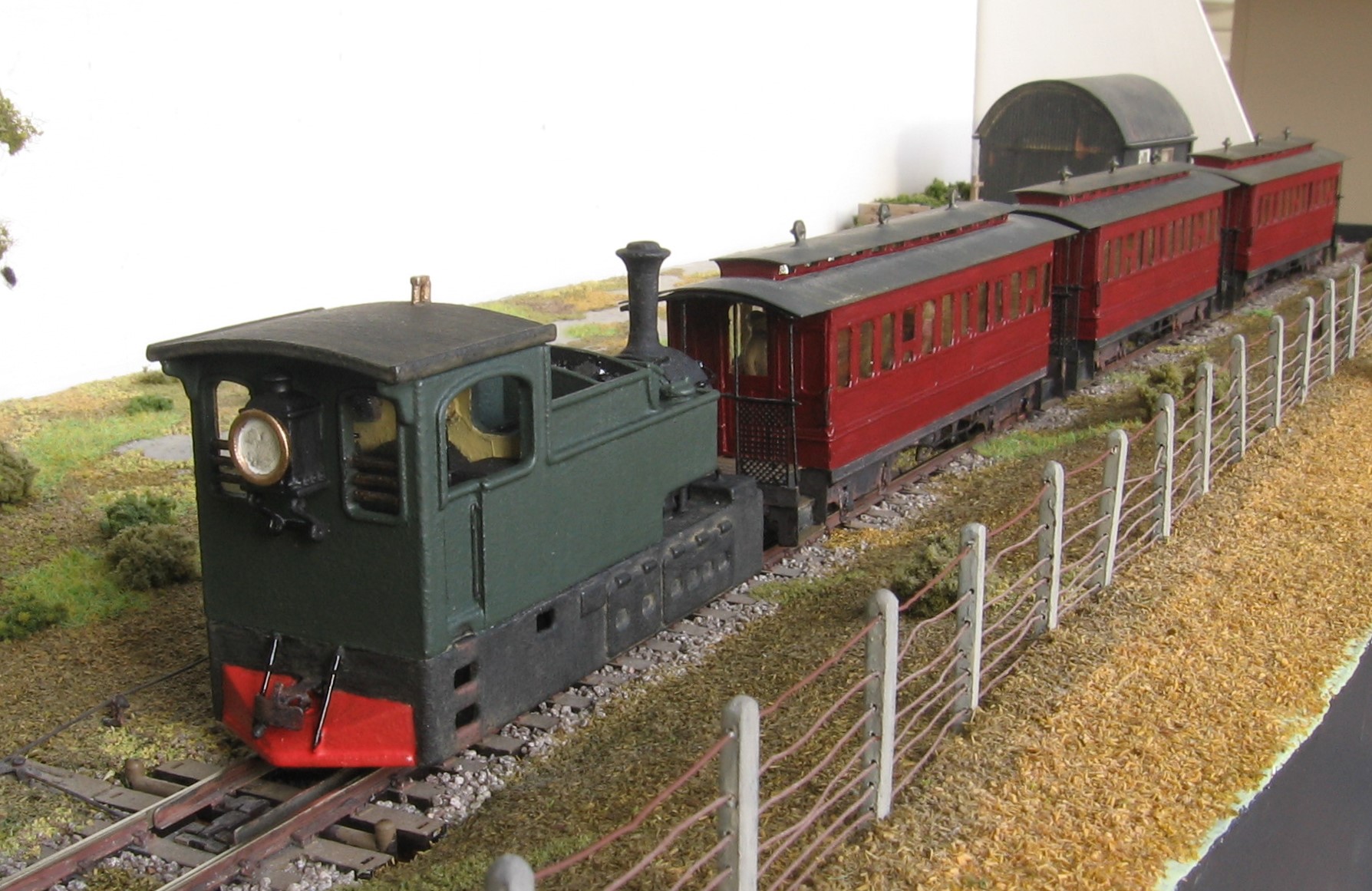

J'ai joint une photo de la locomotive descendant la rue principale de Fivemiletown.
Parmi les deux livres mentionnés, la deuxième édition a beaucoup plus de photographies et de texte supplémentaire. Ils sont chers d'Amazon, beaucoup mieux d'acheter chez un livreur au Royaume-Uni où ils seront disponibles à un prix beaucoup plus raisonnable.
Le modèle dans les photographies est à 1:43 échelle et est par David Holman. La locomotive et l'entraîneur sont des kits en laiton. Ils roulent sur une voie de 21mm. Un très beau modèle. Il peut arriver à Swanley - il ne vit pas loin de là. Il expose - sa mise en page actuelle est Arigna Town - un irlandais standard jauge terminus.

Bonjour Yves,
I am pleased to hear that you like the Clogher Valley Railway.
Some further information for other group members who may be reading this. It was about 60 kilometres long and much of it ran beside the road as a tramway (it was called the Clogher Valley Tramway during its first year of operation). In places it struck out across country due to hills being too steep to climb or taking a short cut. In Tynan and Fivemiletown the railway ran down the main street - very unusual for a railway in Britain or Ireland, but common in parts of France.
I have attached a photo of the loco running down Fivemiletown main street.
Of the two books mentioned the second edition has many more photographs and some additional text. They are expensive from Amazon, much better to buy from a book dealer in the UK where they will be available at a much more reasonable price.
The model in the photographs is to 1:43 scale and is by David Holman. The loco and coach are brass kits. They run on 21mm gauge track. A very fine model. It may get to Swanley - he does not live far from there. He does exhibit - his current layout is Arigna Town - an Irish standard gauge terminus.

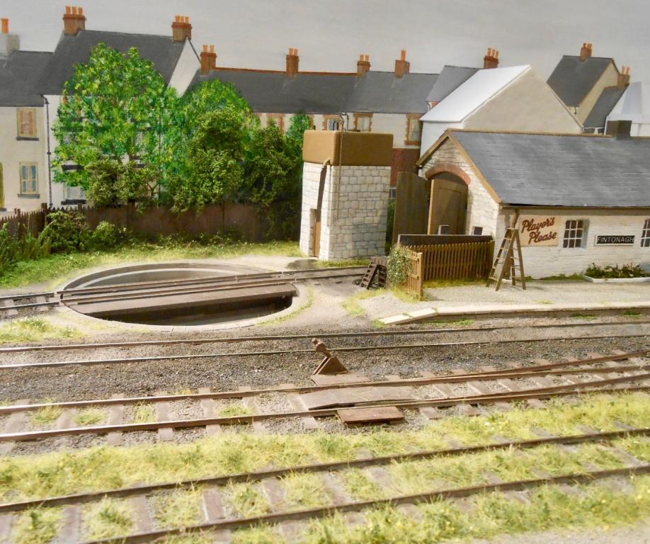

Jolis réseaux que ceux de David Holman.
- ARIGNA TOWN :
Tiens, un "railbus", un sujet à la mode sur PME en moment !
Le réseau en vidéo :
Appréciez la technique digitale !!!
Pour en voir plus :
http://www.rmweb.co.uk/community/index. ... igna-town/
http://irishrailwaymodeller.com/showthr ... -s-scenery

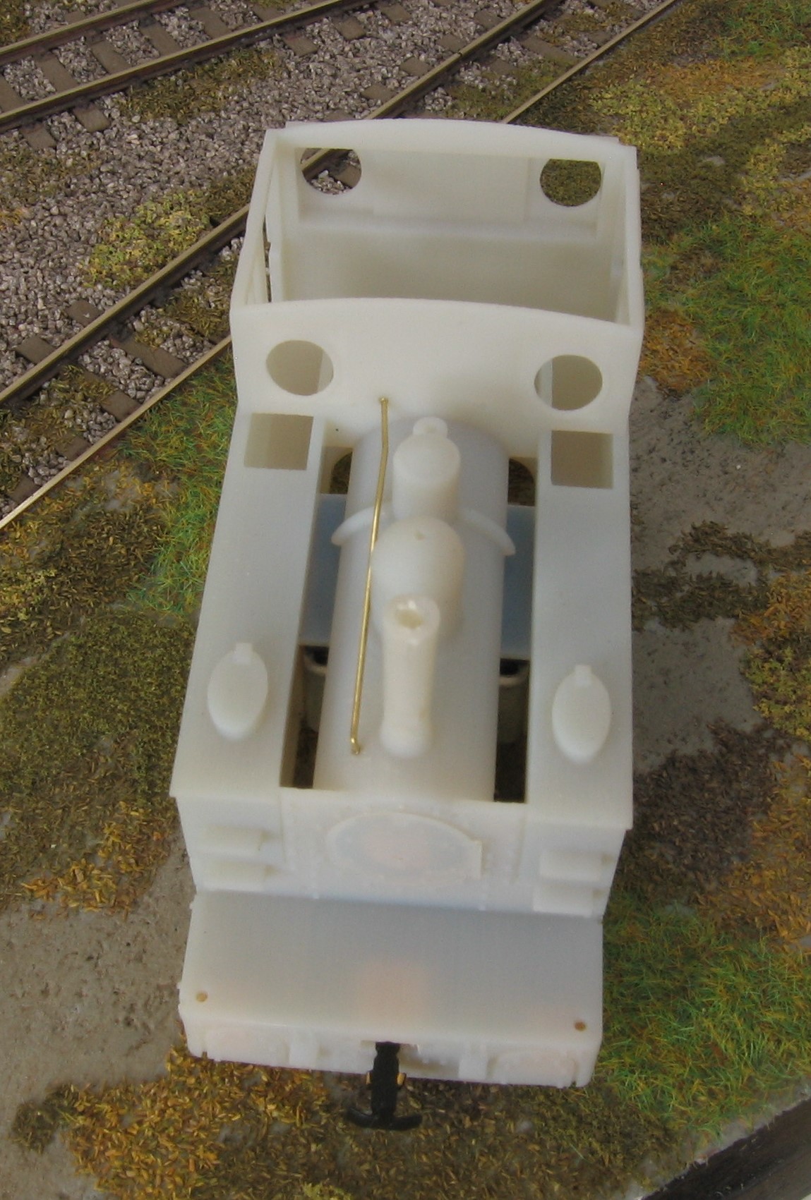

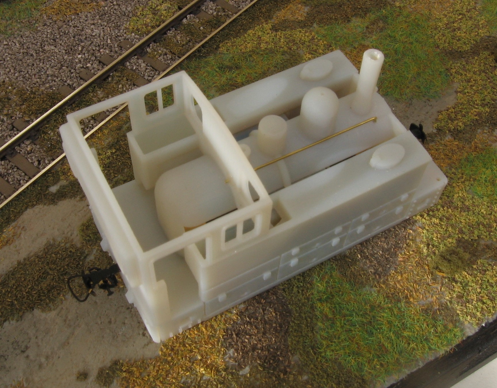

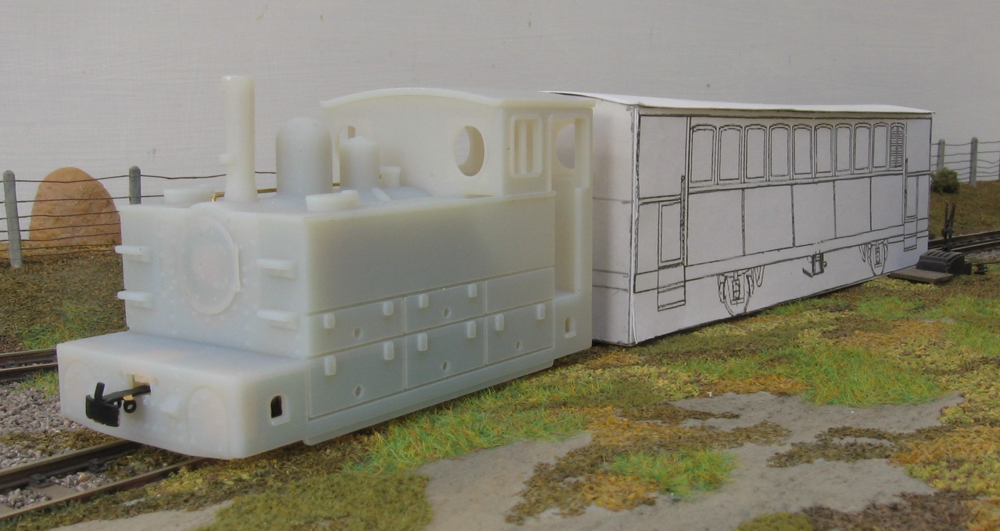

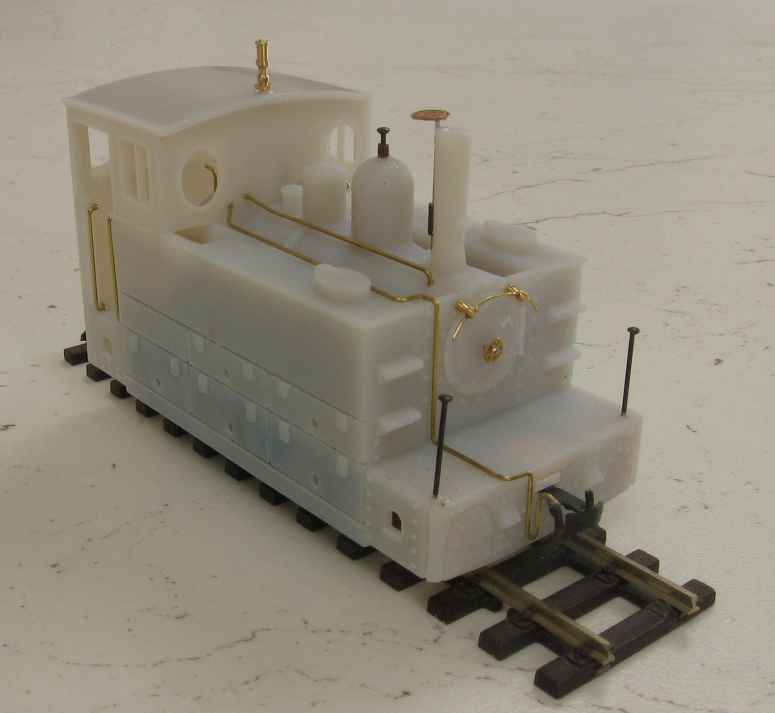

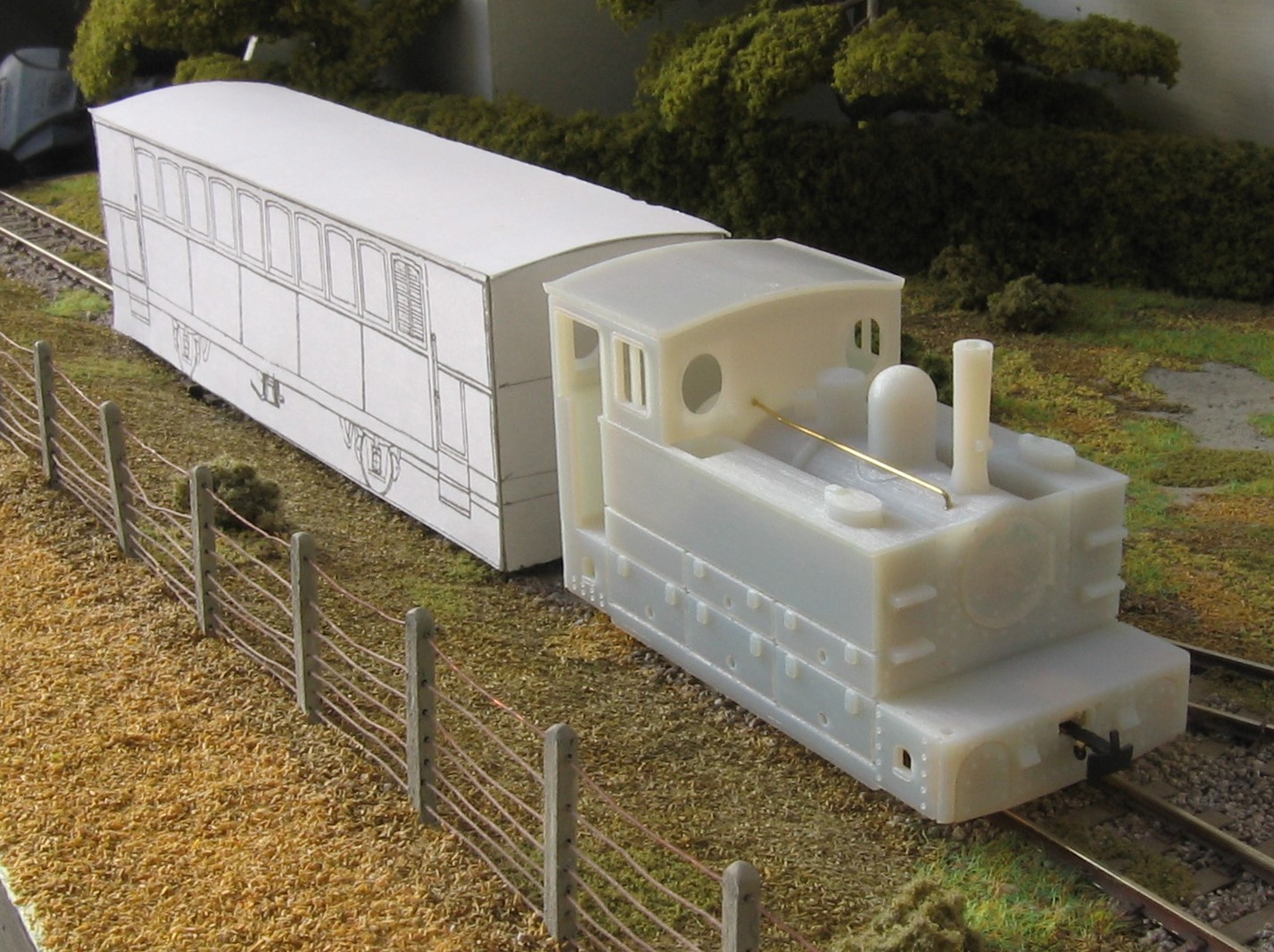

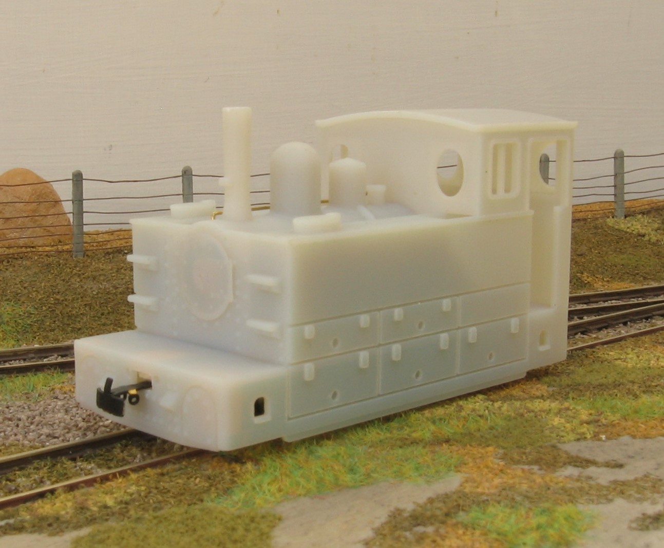

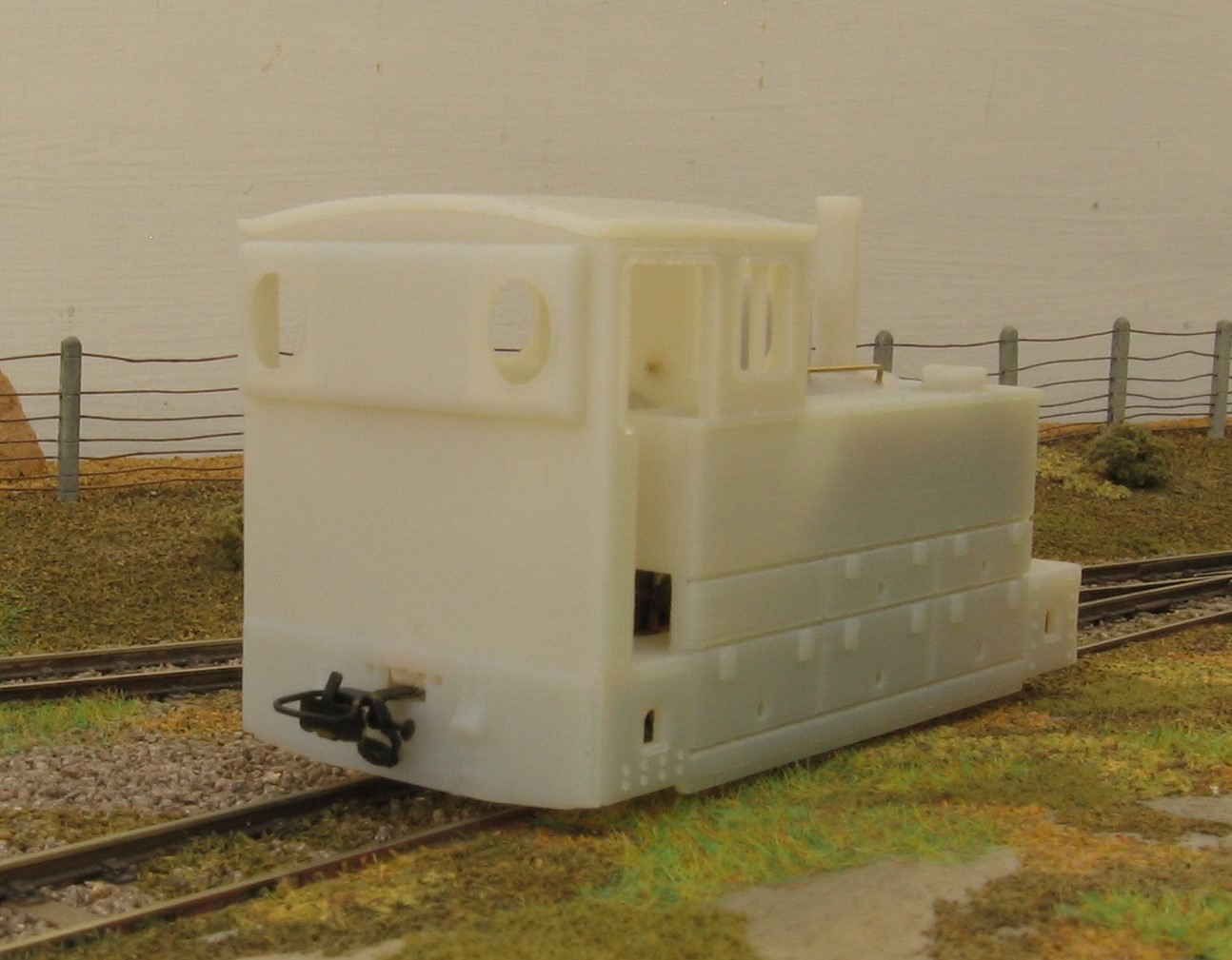

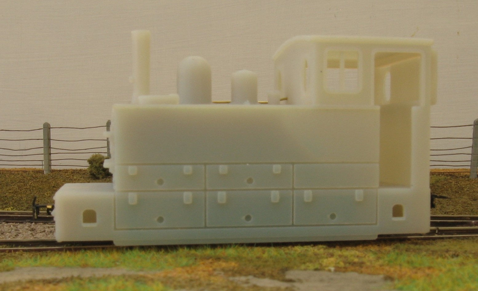

Messagepar Paul T » 01 03 2017 à 11:50
Chers tous.
Enfin :^) . Une photo aujourd'hui, plus demain. C'est la preuve de copie - des changements sont nécessaires, en particulier la cheminée et le dôme. Commentaires bienvenus - Je veux que ce soit aussi correct que possible.
Meilleurs vœux,
Paul
Dear all.
At last :^) . One photo today, more tomorrow. This is the proving copy - changes are needed, especially the chimney and dome. Feedback welcome - I want this to be as correct as possible.
Best wishes,
Paul
Paul T
Messages: 213
Enregistré le: 08 12 2013 à 22:40
Localisation: près de Manchester.
Re: Blanc-Misseron 030-T tram loco from the CdF Cotes du Nor
Messagepar YVES » 01 03 2017 à 18:12
Prometteur ! Effectivement, la cheminée et le dôme semblent un peu sous-dimentionnées.
Bon courage pour la suite.

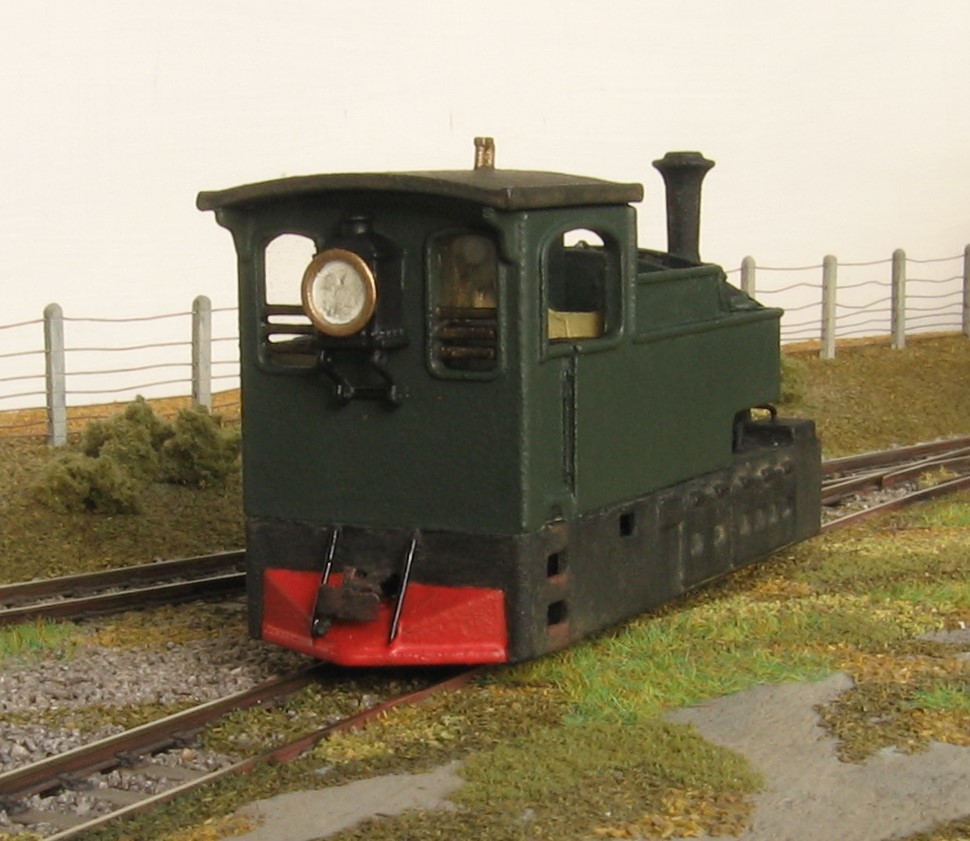

Messagepar Paul T » 02 03 2017 à 10:38
Merci Yves, vous avez tout à fait raison.
Il ya quelques améliorations qui doivent être faites.
1. La cheminée. Cela doit se rapprocher de l'avant de la boîte de fumée - de sorte qu'il est de 2mm (équivalent à 15 cm) de l'avant. AUSSI la cheminée a besoin de faire plus large - 4mm au-dessus du col (équivalent à 30 cm).
Je me demande aussi si la cheminée a besoin d'abaisser en hauteur - les photos semblent suggérer qu'il n'était pas plus haut que le toit de la cabine. Que pensent les autres?
2. Le grand dôme. Cela nécessite une augmentation de la largeur (pas de la hauteur) de sorte qu'il a un diamètre de 9 mm (équivalent de 67 cm) et que sa ligne centrale doit avancer de 1mm (7 cm équivalent)
3. Le couvercle de vanne (par cabine) doit être plus grand (à la moitié de la hauteur du dôme de sable) et doit être élargi d'environ 1 mm. Il a également besoin de revenir en arrière vers la cabine de 0,5 mm.
Ce sont les changements importants.
Il ya des détails rivet à l'arrière de la feuille de la cabine est là - l'appareil photo ne pas le ramasser. Je vais voir si elle peut être mis sur les côtés du réservoir ainsi.
La rétroaction est bien venue.
Meilleurs vœux,
Paul
Francais par Google translate :shock:
Thank you Yves, you are quite right.
There are a few improvements that need to be made.
1. The chimney. This needs moving closer to the front of the smoke box - so that it is 2mm (equivalent to 15 cm) from the front. ALSO the chimney needs making wider - 4mm above the collar (equivalent to 30 cm).
I also wonder if the chimney needs lowering in height - photos seem to suggest that it was no higher than the cab roof. What do others think?
2. The big dome. This needs increasing in width (not height) so that it is 9mm in diameter (equivalent of 67 cm) and its centre line needs moving forward by 1mm (7 cm equivalent)
3. Valve cover (by cab) needs to be taller (to half the height of the sand dome) and needs making wider by about 1mm. It also needs moving back towards the cab by .5mm.
These are the significant changes.
There is rivet detail on the rear of the cab sheet is there - the camera does not pick it up. I will see if it can be put onto the tank sides as well.
Feedback is well come.
Best wishes,
Paul

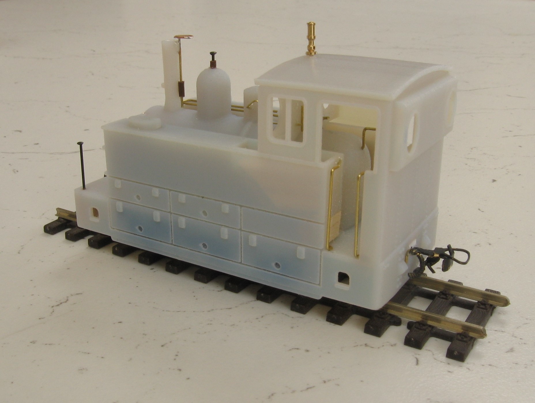

Messagepar Paul T » 02 03 2017 à 10:45
Je pense aussi à des modifications à l'intérieur de la cabine.
1. La fin des soutes à charbon doit être déplacée à l'intérieur de la cabine d'environ 4 mm.
2. La boîte à feu cache le volant. Je pense que juste le secteur supérieur doit être présent et réduit à seulement 5mm de profondeur (l'équivalent de 37cm). Le volant peut être peint en noir et l'équipage de la locomotive cachera ce qui se trouve à l'intérieur de la cabine.
S'il vous plait, faite moi part de votre avis.
Je suis en contact avec Chris ce week-end (4-3-17) pour faire les modifications. Désolé, il n'y a pas beaucoup de temps.
Francais - Google translate! :H2
Paul
I am also thinking of modifications inside the cab.
1. The end of the coal bunkers need to be moved inside the cab by about 4mm.
2. The fire box hides the flywheel. I think that just the top area need to be present and cut back to just 5mm deep (equivalent of 37cm). The flywheel can be painted black and loco crew will hide what is inside the cab.
Please let me know what you think.
I am getting in contact with Chris this weekend (4-3-17) to make the modifications. Sorry there is not much time.
Paul

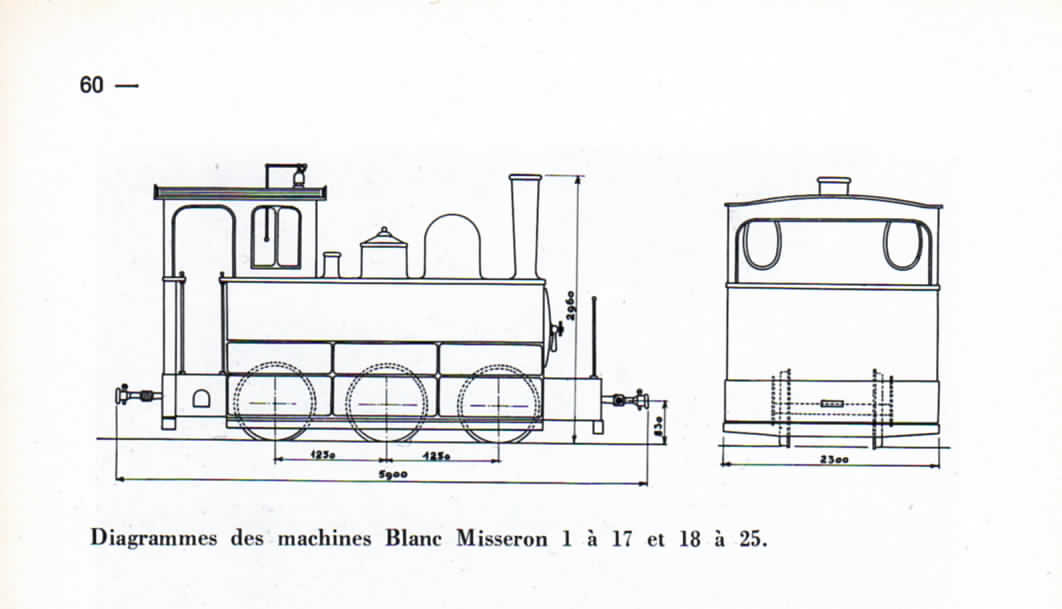

Messagepar mlm » 02 03 2017 à 12:21
Si ça peut t'aider, voici un dessin simplifié des 030 BM 1à 17 des CdN. Le dessin est extrait du n°131 (1975- V) de Chemins de Fer Régionaux et Urbain édité par la FACS

Messagepar Paul T » 02 03 2017 à 13:17
Merci pour les réponses.
J'ai regardé le lien Pierre. Il ya quelques bonnes informations là-bas. Les locos de la Sarthe étaient très semblables, mais pas les mêmes. Les locos étaient plus étroits pour commencer où ceux sur les Côtes du Nord étaient plus larges (comme étaient sur le Reseau Bretton). J'ai utilisé des photos des locos de Sarthe pour les aider à certains égards.
Mlm merci aussi pour l'affichage du diagramme. J'ai une copie - ça m'inquiète. Je pensais que c'était un diagramme d'échelle mais ce n'est pas, c'est un croquis dimensionné et je ne suis pas sûr de certaines des dimensions données! Comme je l'ai mentionné photos semblent suggérer que la cheminée n'était pas plus élevé que la cabine - ce diagramme montre une image très différente. Je suis heureux de participer à un débat!
J'avais pensé qu'il y avait une «norme» pour tout le mètre jauge sur les systèmes ferroviaires français, mais j'ai réalisé qu'il y avait des variations entre les différents reseau.
Messagepar Paul T » 03 03 2017 à 12:08
Chers tous.
Je pense qu'il vaut mieux expliquer pourquoi je ne suis pas entièrement convaincu par le dessin du Blanc-Misseron (série 1-17).
1. Le diagramme. Sur la copie je l'ai est placé au-dessus des diagrammes (élévations latérales et arrière) des locos 18-25 de Blanc-Misseron. Ceci semble être un dessin beaucoup plus complet avec des lignes centrales, etc. et je suis convaincu de sa précision.
Le dessin des locos 1 - 17 lutte avec l'échelle, en particulier sur les niveaux horizontaux. Sur mon impression la hauteur du haut de la cheminée au niveau de rail est 59mm. Pour l'échelle, il est de 19,9 mm = 1 mètre. La longueur est de 117 mm et cela donne une échelle de 19,8 mm = 1 mètre. L'empattement est de 49mm ce qui se traduit par une échelle de 19,6mm = 1 mètre. Je n'ai pas de problème avec cela - une partie de l'écart pourrait être due à la copie et l'impression.
La hauteur de l 'accouplement est de 830 mm, ce qui ne me gêne pas (voir le diagramme des locomotives de la série 18 - 25, c'est aussi la hauteur de l' accouplement du Reseau Breton qui a du sens). Sur le diagramme, la distance est de 10mm, ce qui donne une échelle de 12mm = 1 mètre. À 19,9 mm par mètre (à l'aide de l'échelle verticale) 830 mm mettrait l'accouplement à 16,5 mm au-dessus du niveau du rail qui est au-dessus de la hauteur de la plate-forme illustrée sur le diagramme. Hmm. J'espère que mon arithmétique est correcte #A8 . Cela met en question les lignes horizontales sur le dessin et éventuellement le choix des lignes verticales et est un facteur important dans mon doute.
2. Photographies. Je me suis surtout appuyé sur les photos du Petit Train des Côtes-du-Nord et quelques photos fournies par l'Association des Chemins de Fer des Côtes-du-Nord.
Le dessin montre que les jupes latérales (plaques latérales) ne se rapprochent pas du sol, mais les photos montrent qu'elles se rapprochent beaucoup plus du sol. Voir les pages 50-51, 53 et 62-63. En utilisant ces photos ainsi que la cheminée semble être pas plus grand que le toit de la cabine. Il est plus squat que montré dans le dessin. D'autres détails sont erronés ou manquants. Les poteaux verticaux à l'avant de la locomotive sont trop hauts, la marche avant des jupes latérales est manquante, la chaudière semble se dresser juste au-dessus des réservoirs latéraux (d'où la courbe légère du devant de la caisse de fumée) qui est absent sur le dessinet et les marches sur les réservoirs sont omis.
Il semble qu'il n'y ait pas de dessins techniques des locomotives - peut-être ont-ils été détruits pendant la guerre ou avec la fermeture des travaux. S'il y avait alors je suis sûr qu'un modèle aurait été produit il ya des siècles. Je sais que j'ai commis quelques erreurs, mais j'espère que je serai plus près d'obtenir un modèle à l'échelle qu'à ce jour. Ça a été un travail difficile! :(

Messagepar Paul T » 13 03 2017 à 14:16
Chers tous,
Deux nouvelles photos ajoutées montrant quelques détails supplémentaires de la locomotive. J'ai utilisé principalement du fil de laiton, deux poignées de la main courante, un sifflet, des broches de piste de PECO, la balsa et la gaine en plastique du fil fin. Le berceau de moteur a été rendu plus serré avec la carte en plastique. Les accouplements sont des raccords Greenwich.
La loco est maintenant préparée pour la peinture.
Le programme mis à jour avec des modifications a été préparé et dès que je le recevrai je le transmettrai aux imprimantes - espérons-le pas trop longtemps pour attendre.
Meilleurs vœux,
Paul
Dear all,
Two new photos added showing some additional detailing of the loco. I have used mostly brass wire, two handrail knobs, a whistle, PECO track pins, balsa and plastic sheath from fine wire. The motor cradle was made tighter with plastic card. The couplings are Greenwich couplings.
The loco is now prepared for painting.
The updated programme with modifications has been prepared and as soon as I receive it I will forward it to the printers - hopefully not too long to wait.
Best wishes,
Paul
